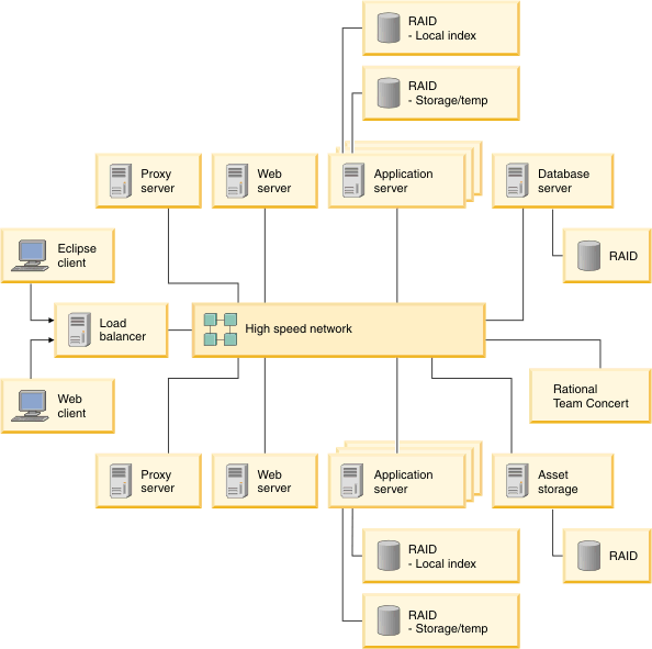

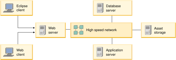

Example deployments
The following two figures
show deployment examples.
This figure shows a simple deployment
that supports up to 100 users:
This figure shows
a complex system that can support more than 100,000 users:

A large IBM WebSphere Application Server cluster
is composed of front end HTTP servers and proxy servers with a load
balancer that directs requests around the cluster.
You can scale WebSphere Application Server both
vertically and horizontally. Use a dedicated database server and file
server. The degree to which WebSphere Application Server can
be scaled and the number of servers that you can use depend on the
type and magnitude of server requests and the number of assets.
IBM HTTP Server
The first tier is the HTTP server, which
handles requests from Web clients and relieves the application server
from serving static content. It provides a logical URL that encompasses
ancillary applications, such as the IBM Rational Asset Manager application,
the Rational Asset Manager Help
application, and the Rational Asset Manager Asset
Based Development application. Note that in a large configuration,
a cache server is deployed in front of the HTTP server.
Load
Balancer
A load balancer distributes load across
a number of systems. If you have more than one HTTP server, you must
use a load balancer. For moderately sized deployments, use a software-based
load balancer, such as Edge Component. For larger deployments, which
support a large number of concurrent users, use a hardware-based load
balancer.
Cache Proxy
A forward-caching proxy
system stores application
data for clients in a cache and relieves load from other server systems.
If your Rational Asset Manager server
supports a moderate number of concurrent users, you need only one
forward proxy system. If your Rational Asset Manager server
supports a large number of concurrent users, you might need multiple
proxy systems.
Application Server
The Rational Asset Manager EAR
file is comprised of two WAR files: the repository and Web application
file and the Web services file. Deploy the Rational Asset Manager EAR
file on every WebSphere Application Server instance
in a cluster. Rational Asset Manager also
includes Help and IBM Rational Unified Process (RUP) WAR files; you do not have
to deploy these WAR files. If high availability is not required for
the Help and RUP support functions,
deploy them on a single WebSphere Application Server instance
or on an external WebSphere Application Server container.
The Rational Asset Manager repository
is normalized for searches and data retrieval so that data is stored
in a manner that is designed to make searching for data, browsing
artifacts, and downloading assets more efficient. To do so, every Rational Asset Manager server
instance builds a local index for assets and a local index for artifacts.
This optimizes search performance, relieves database load, and enhances
scalability in a clustered environment. Local index directories might
perform better than an index that is shared across nodes.
Database
server
The most important considerations in
choosing database hardware are the number of disks in the machine
and the RAID schema that the machine uses. A RAID array should contain
at least 6 to 10 drives for every processor. While memory is important,
there is no significant difference between database server configurations
with 4GB and 8GB of memory for 1000 users and 50,000 assets.
Database
disk space requirements depend on many factors: the number of assets,
the number of artifacts for each asset, the number of team spaces,
the number of roles, the number of reviews, the number of asset types,
the number of users, the amount of transactions on the server (user
metrics), and quantity of forum discussions.
File
server
Assets must be shared across WebSphere Application Server instances.
Use a concurrently accessed file system. Rational Asset Manager accesses
these files only during uploads, downloads, artifact indexing, and
significant changes to the Rational Asset Manager model
that require an asset manifest update.
